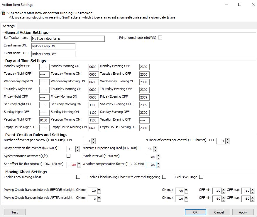

Okay, I was maybe not clear enough:

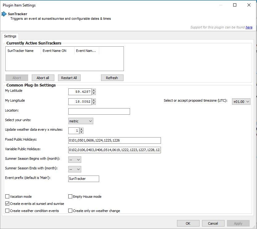

If you are only interested in having sunset/sunrise events, you should only need to have the plugin running with the check-box "Create events at sunset and sunrise" ticked (the same is valid for weather condition events)
If you also have the need to control devices like lamps etc with additional specific time settings, you create as many actions as you need. Those actions with their settings will run independently, means you have the flexibility to control various devices with different times & other settings. To make an action work, you have to insert at least one time setting for each day-type (in my earlier example 1100, this is a shortcoming of my coding...). If you do only that, you will get those action specific events also at sunrise & sunset. You can then modify this further by adding time settings, offsets and other conditions.
Let's assume we have an indoor lamp you would like to control in the following way:
- turn on every weekday morning and turn off 30 minutes after sunrise
- turn on 30 minutes before sunset and turn off at 23:00 on weekdays (or days before you have to go to work, normally sundays will unfortunately be such a day)
- have different settings for Fridays, Saturdays, vacation and away mode
- you like to weather compensate with maximum 30 minutes (means during bad weather it turns on/off 60 minutes before sunset and after sunrise)
The configuration for such an action could look like this:
thedude
Posts: 13
Joined: Sun Apr 17, 2016 6:41 am
Post by thedude » Tue Apr 19, 2016 9:44 pm
krambriw wrote:
Alright, I think I have a better understanding now, thanks very much. Adding a separate action is used for custom schedules at specific times irrespective of actual sunset/sunrise. Plugin check-box is strictly for setting weather.com's sunset/sunrise time based triggers.
Only thing I'm still a bit fuzzy on is the "turn off 30 minutes after sunrise and turn on 30 minutes before sunset, turn off at 23:00 on weekdays" bit because of the single option for offset ("Set offset for this control: -30"). -30min to me is "30 minutes before" and because there is only one toggle for offset, wouldn't it affect all the scheduled times you have? So it would turn off 30 minutes before the sunrise (0530), not after. And 30min before 2300 on weekdays, not on the dot. What part of the config is allowing for different offsets for different day-types?
It's a shame you can't use offsets with weather.com's sunset/sunrise times from the plugin check-box or do the fields in the separate action schedule use weather.com's time for sunrise/sunset if you put "1100" just in the 'Morning ON' day type as you described ?
The real problem for n00bs is not knowing what part of your example matches up with the settings field, I made this is quick diagram with Sharex(great tool as well) for the 1st post if you like: https://i.imgur.com/fuQ9D4i.png
Post by krambriw » Wed Apr 20, 2016 5:02 am
As it is implemented it will work the way I described. In this example with -30 it will turn on 30 minutes before sunrise and 30 minutes after sunset. For an indoor lamp this makes sense if you think about it. Setting +30 minutes works the opposite way and could be useful for outdoor lamps
You can't do that in a single action. Only way is to add additional actions with individual settings. If you are controlling the same device from two (or more) different actions you need to be careful to avoid conflicts (i.e. have one action for specific day-types or using other EG methods like the disable/enable macro action)
All actions are using the plugins variables for weather and sunset/sunrise. In the actions you are just adding additional conditions
Yes, the whole plugin is a bit complex and has grown to that during the years (first version is dated back in April 2008). I think best is to think that the plugin provides generic settings, actions are adding specifics on top only valid for the action itself.

today im using a nexa dusk relay (skymningsrelä) with a tellstick duo, and the relay doesnt always work, so i have just started to look at the suntracker.
I just want the suntracker to start my lamps when the sun goes down, and the lights to go of when the sun comes up, is this possible with the suntracker?
I have looked through the forum thread, but i cant understand how i should configure this task.
could you give me an easy way of how to config it the way i want.
thank you !
Post by krambriw » Sun May 29, 2016 5:43 am
Yes
Configuration as simple as possible to do exactly that:
1) Install and configure the SunTracker and TellStickDuo plugin
2) find and insert your lat/lon coordinates
3) create macros to control your devices with the TellStickDuo plugin actions
tjabas
Posts: 98
Joined: Sun Feb 07, 2016 6:28 pm
Post by tjabas » Sun May 29, 2016 1:26 pm
thank you.
but i have a strange problem, i cant get to the bottom of the suntracker settings, the onlything i can see at the bottom are summer ends with....
i cant seem to scroll down more then that.
What i mean is that i cant see the field: create events at sunset and sunrise, i have tried several screen resolutions and stuff to get to see the lower part of the settings menu, but i cant, is there another way to edit the settings?
any suggestions?
Post by krambriw » Sun May 29, 2016 7:15 pm
a) Recommended solution: Invest in a new monitor with higher resolution
b) Last resort solution: open the SunTracker plugin dialog without clicking anywhere in the view, use the keyboard and press the TAB button 17 times, press SPACE button once, then press TAB button 3 times, then press ENTER button once
tjabas

i use teamviewer to remote control my win xp computer that uses eventghost, i managed to change the resolution in teamviewer and voila, i could suddenly see the bottom of the suntracker settings, thanks for the advice.
i have done settings exactly as you showed me in the settings dump, exept the location then :)
and i have added a event by rightclick and add an event, and name the event exactly as you showed me, can i test it somehow?
or do i need to wait for tomorrow for the sunrise?
Post by krambriw » Sun May 29, 2016 9:25 pm
Unfortunately there is no easy way to test those events except waiting until conditions are met (means you have to wait for sunrise/sunset to happen). There is however one way where you could force the events to happen and that is to figure out a suitable setting for lat/lon so that you will experience the event in a "short while". Like where will sunset happen in the next five minutes and then configure and wait, then the event should happen. And then do the same for sunrise....
Thinking about it, it might not be enough, you may most likely also change your time zone settings.....so I would say, you should just wait
You can however check that your settings are correct by using one of the available actions in a python script:
print eg.plugins.Suntracker.GetTimeFor_SunSet_SunRise()
When I run it I get the following that is correct for my location
23:37:09 ('Up|0345', 'Down|2144')
