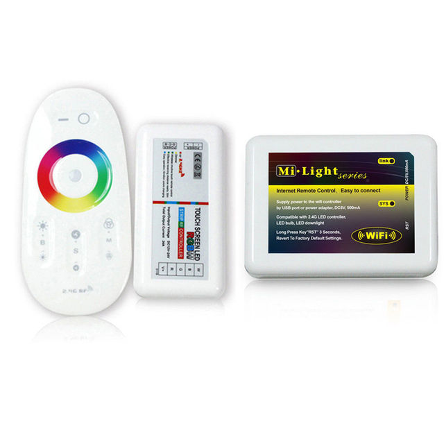

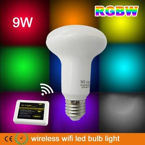

The only limitation I want to discuss with you, is the support of the older RGB protocol. We could say "well, RGB refers to obsolete devices, let's forget". My 2 RGBW Led strip controllers are using the old RGB protocol, and I may be interesting to suppport it.
I did a few tests, and discovered that my brand new 9w milight spot bulb is RGBW, so working with your scripts, and in the same time fully backward compatible with RGB protocol.
About the changes on your code : the main difference between RGB and RGBW protocol, is the prefix that changed from 2x to 4x, and the zone management. On a quick and dirty approach, changing the prefix code only would work without re-writing all your plugins.
So this is the todo list I propose :
- Use a prefix code table : RGB / RGBW
- Allow the "multi instance" mode, so that one can instanciate one plugin for each mode (optionnal)
Sooner or later I'll make a dirty test. Let me know your opinion about this upgrade.

To me, the main advantages of LED Strips with the RGB protocol is that they CAN produce bright pastel colors, as they can combine white + color outputs. Unfortunately this is achieved using a trick : there is to set a specific "disco" mode to combine white + color. Which is not easy to control by script (but not impossible).
I have a spare controller using the RGBW protocol, I'll test it to check the difference with the older ones, but I'm not shure it can combine White + Color. One thing I found disappointing on the new protocol, is that the disco modes can't be adressed directly, and worse, you can't do "up/down" like the older one, but only "up". Because there are 20 programs, it is really a pity.

I'd really like to be able to get some LED RGB strips and control them from Eventghost, which ones are best/cheapest?
Also is it possible to control all strips at once instead of strip-by-strip?
