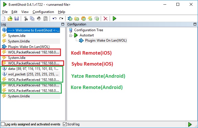

Ok I ran the plugin and got these results:
The iOS Remotes ran fine with no errors.
The Android remotes however had an issue.
Yatze remote, gave some error/data.
Kore remote gave an instant double WoL
Here's the data from Yatze.
data: [89, 97, 116, 115, 101, 83, 116, 97, 114, 116, 45, 88, 98, 109, 99]
wol_packet: [255, 255, 255, 255, 255, 255, 52, 230, 173, 14, 67, 19, 52, 230, 173, 14, 67, 19, 52, 230, 173, 14, 67, 19, 52, 230, 173, 14, 67, 19, 52, 230, 173, 14, 67, 19, 52, 230, 173, 14, 67, 19, 52, 230, 173, 14, 67, 19, 52, 230, 173, 14, 67, 19, 52, 230, 173, 14, 67, 19, 52, 230, 173, 14, 67, 19, 52, 230, 173, 14, 67, 19, 52, 230, 173, 14, 67, 19, 52, 230, 173, 14, 67, 19, 52, 230, 173, 14, 67, 19, 52, 230, 173, 14, 67, 19, 52, 230, 173, 14, 67, 19]
However, in all instances, they have a proper WoL signal

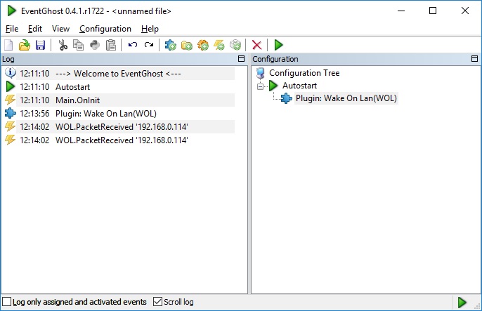

Post by enobhsiw » Mon Oct 02, 2017 9:18 am
Well, both the signals are almost instantaneous, just a few milliseconds apart I would say.
Your idea would be nice as it would stop WoL spam on network, or atleast prevent 2 remotes sending a signal simultaneously.
