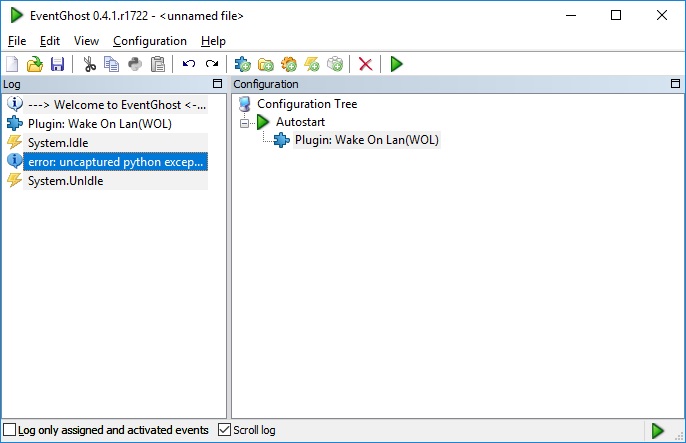

I ran the plugin and got this error
error: uncaptured python exception, closing channel <eg.UserPluginModule.WOL.Server connected 192.168.0.163:9 at 0x4eb15f8> (<type 'exceptions.UnicodeDecodeError'>:'ascii' codec can't decode byte 0xff in position 0: ordinal not in range(128) [asyncore.pyc|read|76] [asyncore.pyc|handle_read_event|414] [C:\ProgramData\EventGhost\plugins\WOL\__init__.py|handle_read|100])

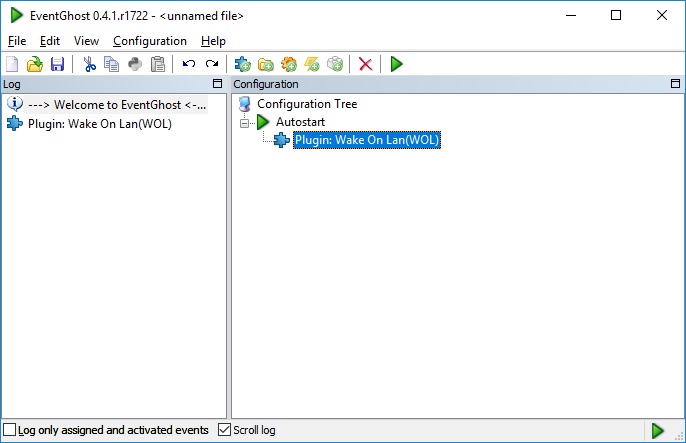

I ran the plugin and there was no reaction at all.

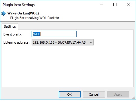

When I hit 'Add Plugin' and whose the WoL plugin, this screen pops up.
After hitting Ok, and sending the WoL packet, no reaction.

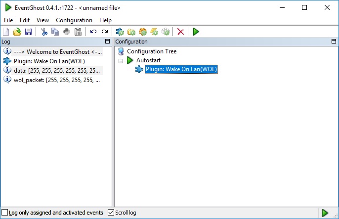

Ok so I ran the plugin and I got the following:
Here's the output
data: [255, 255, 255, 255, 255, 255, 52, 230, 173, 14, 67, 19, 52, 230, 173, 14, 67, 19, 52, 230, 173, 14, 67, 19, 52, 230, 173, 14, 67, 19, 52, 230, 173, 14, 67, 19, 52, 230, 173, 14, 67, 19, 52, 230, 173, 14, 67, 19, 52, 230, 173, 14, 67, 19, 52, 230, 173, 14, 67, 19, 52, 230, 173, 14, 67, 19, 52, 230, 173, 14, 67, 19, 52, 230, 173, 14, 67, 19, 52, 230, 173, 14, 67, 19, 52, 230, 173, 14, 67, 19, 52, 230, 173, 14, 67, 19, 52, 230, 173, 14, 67, 19]
wol_packet: [255, 255, 255, 255, 255, 255, 80, 199, 191, 23, 68, 171, 80, 199, 191, 23, 68, 171, 80, 199, 191, 23, 68, 171, 80, 199, 191, 23, 68, 171, 80, 199, 191, 23, 68, 171, 80, 199, 191, 23, 68, 171, 80, 199, 191, 23, 68, 171, 80, 199, 191, 23, 68, 171, 80, 199, 191, 23, 68, 171, 80, 199, 191, 23, 68, 171, 80, 199, 191, 23, 68, 171, 80, 199, 191, 23, 68, 171, 80, 199, 191, 23, 68, 171, 80, 199, 191, 23, 68, 171, 80, 199, 191, 23, 68, 171, 80, 199, 191, 23, 68, 171]
