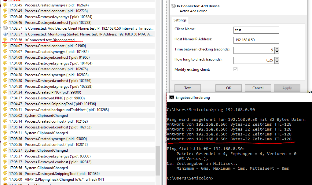

Cool plugin, but doesn't work for me somehow...

Yeah I know it has an issue. Unfortunately it had to be put on the back burner for a little bit. I will be revisiting it soon. It's going to be something that is pretty domb as to why it is not working. It's a pretty simple concept. Create a socket to an IP. If it refuses the connection the host is connected. If it connects the host is connected. If it times out the host is not connected. I know I had it running on my end. I don't know what I may have changed to make it stop working. As soon as I tested it. I packaged it and attached it. Only thing I could have done is packaged up a wrong version of it. I have to check. I will do this when I get home in 8 hours or so

OK I just took a look at this...
I need someone to test something for me.
when adding a device set the How long to check for to 1.5 seconds. this seems to be the sweet spot for detecting the connection properly. and if that is the case I will have to set a minimum on that control to be there if that is the case.

Nope, still doesn't work for me...

maybe try pushing that timeout higher. make it a 5 second thing and see if you get something then.

Nope, it just doesn't work, no matter what I set there

I was having a similar issue. Using with a vizio tv to see if it was on or not. The thing that seemed to make it work was bumping up the 'How long to check' parameter. I am not sure what is optimal but I think I just set it at 2 seconds and it seemed to be rock solid.

This is something I am going to have to tinker with a bit more. all I am doing with this plugin is making a socket connection to the device. if I get a refusal. then the device is there. if I get a connection then the device is there. if it times out then no device. I have to play around with it a bit more to figure out why sometimes i get a timeout before a refusal. it could be that if you make a query to rapidly then it will just simply ignore the request. maybe i should have it select a random port each time. this might solve the problem.
