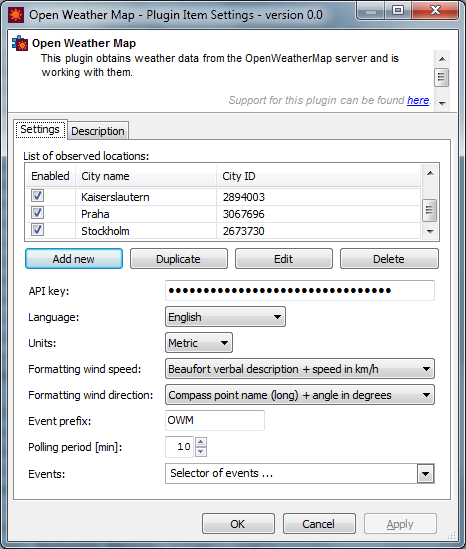

EDIT: 1a. Registered and obtain API key @ openweathermap.org
1b. Add a folder to the plugins folder C:\Program Files\EventGhost\plugins\OpenWeatherMap
2. Copied the file __init__.py to this folder
3. Restarted EG and added the plugin to the tree.
4. Added the ID=2827613 of my town of interest (as shown in the api link) in the plugin's config form + added the city's name "Kaiserslautern" .
API link: http://api.openweathermap.org/data/2.5/ ... id=2894003
5. (Open Weather Map - Folder was added to tree)
6. Configured and ran the Macro Enable City - 'Open Weather Map: Enable city: 2894003'
6a. EDIT: Enter the API key you obtained from openweathermap.org
7. Ran the macro Get current weather - 'Open Weather Map: Get current weather'
[SOLVED with 1a, 6a: But this only ended with the event log entry...
OpenWeatherMap: {u'message': u'Error: Not found city', u'cod': u'404'} ]
EDIT: I set the polling period to 10 min., but no events appeared the last 30 minutes.
[Solved with 1a, 6a: What did I wrong? I assume the 404 is a 'page not found'
The api link worked fine at the same time in Firefox, also http://openweathermap.org/city/2894003 was up and running.
Many thanks in advance!]

Re: OpenWeatherMap
Post by Pako » Mon Oct 13, 2014 8:37 am
I have no idea why it does not work for you.
Perhaps only one idea: You have registered and obtained API key you entered in the appropriate field?
Unfortunately, I can not see your computer.
For me, it behaves normally.
Can someone please write if it works elsewhere?
Thanks, Pako

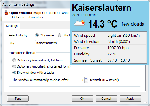

aaah, ok. :idea: the api key field was blank ...
I registered @ OWM, got my Api key and everything worked well. So I get a result for "(o) Show window with a table" like you showed in your mailing before
Read first, then ask - I thought you just poll the weather data using the http://api.openweathermap.org/data/2.5/ ... id=2827613 and haven't read about the registration and the API @ OWM :oops: I promise to improve - sorry!
...and it fires a event !
OWM.Temperature.Kaiserslautern (14.66, u'2894003') :D

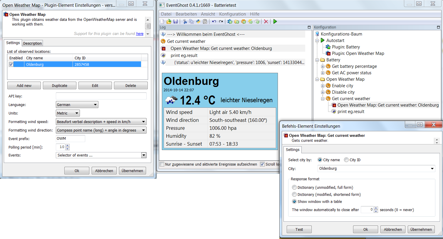

I tried the plugin without using the API field and I did not register at OWM. But I get a result from the plugin. Is this ok?
