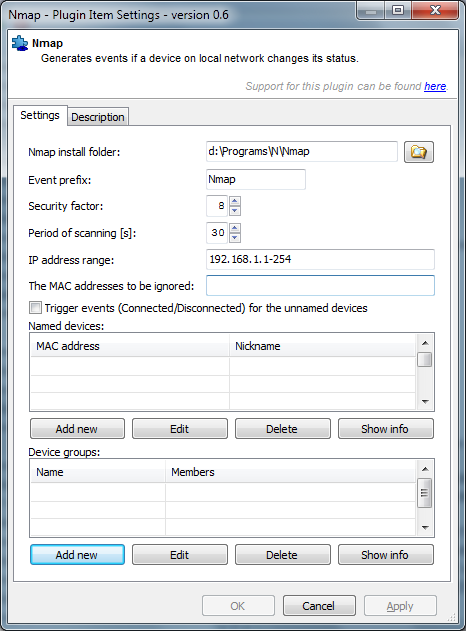

Re: Nmap
Post by Pako » Tue Jul 22, 2014 6:18 am
It is really very easy. You are afraid of nothing.
So I'll try to help.
For proper operation you must install Zenmap. It is done.
Then you have to add Nmap plugin to EventGhost. This is also done.
Now open the configuration dialog:
First, you would do well to read what is written on the Description tab.
Now we will discuss the setup procedure:
1.) Box Nmap install folder - check here (or fix) folder, in which Zenmap is installed
2.) Event prefix - you can leave it as it is
3.) Security Factor and Period ... - do not change it for now. Later, you can experiment with how changes will affect the reliability
4.) IP addres range - here set the range of IP addresses to be scanning (for example by setting DHCP server). More preferably, the range is small.
5.) Now press the Apply. This will start the regular scanning.
6.) The MAC addresses to be ignored - you can leave it as it is
7.) Trigger events ... - you can leave it as it is
8.) If the step 5.) was completed successfully, you can press the button Add new (under the section Named devices) and add there the device you want to monitor.
It may be that you do not find your phone there immediately. In this case, you can wake it up and try it for a few seconds again.
9) click OK to close the dialog and from the menu EventGhost select File and Save.
