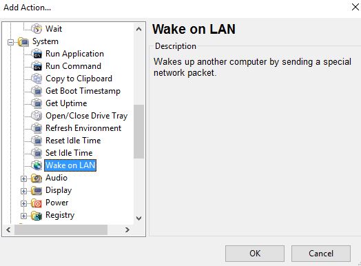

Navigate to: [Settings] → [Network] → [Home Network Setup] → [IP Control]
Set [Authentication] to [Normal and Pre-Shared Key]
There should be a new menu entry [Pre-Shared Key]. Set it to 1111, or you can change it to something else, and set the plugin accordingly.
The screenshot is how to use a WOL packet.

OK so i did a little modification to the code. this is backwards compatible (well... it should be...).
I cleaned up the code.
I restructured how the macros get added when the plugin gets installed.
I removed the use of "global"
I changed how the SOAP string gets written.
I added a help section
I added a WOL feature that will automatically work if you select the option in the plugin config
I re wrote the config dialogs (better formatting)
I changed the use of old eg.RegisterPlugin parameters.
I added internationalism support
Plugin is attached. simply double click the file
I do not own a Sony TV so there could be a bug or 2. so hopefully someone will lend a hand and test the thing
SonyNetworkRemote-0.0.3.egplugin
(6.41 KiB) Downloaded 146 times

Well, I'll be damned...Guys, it's working :) I didn't find the Pre-Shared Key Settings, but adding the IP and MAC-Address worked. I can turn on my 2013 Sony TV using Eventghost.
THANK YOU SOOOO MUCH :)
