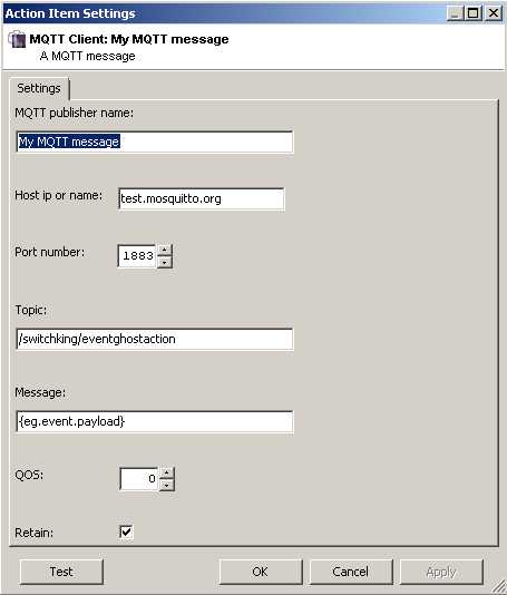

To publish a message to the broker, you need to configure a macro with a publishing action. Select the action "Publish a MQTT message" and the following dialog will appear:
The first part of the configuration like name of the action, broker host name or ip and port number is self explanatory I think.
When you define the topic, it is important that it is the same as the one clients are subscribed to, otherwise they will not receive the messages.
The message itself can be any fixed string or it can also be dynamic using {eg.event.string} or {eg.event.payload} like in this example:
The 'QOS' (Quality Of Service) can be selectable 0,1 or 2.
The 'Retain' can be set either True(checked) or False(unchecked)
