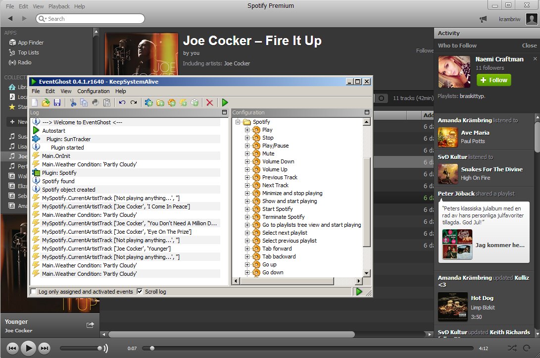

Okay, here is a version that fires events
- when the artist/track changes
- when nothing is played
I think the second event is also needed to allow easy updates of GUI's when nothing is played, otherwise the last played track will remain in the GUI (if you use websockets or CommandFusion, you can use both events to update the page elements correctly)
Typical events look like this in my tests:
15:54:44   MySpotify.CurrentArtistTrack ['Not playing anything...', '']
15:54:46   MySpotify.CurrentArtistTrack ['Lana Del Rey', 'Without You']

Update: the plugin only give me triggers in EG if spotify was running when EG started.
any idea why this would be?
Re: Spotify
Post by krambriw » Fri Dec 27, 2013 10:09 am
Thanks for reporting back.
I saw some issues with my code so I have improved and hopefully made it work better. In my tests, I can now start EG and the Spotify plugin without problems independent if Spotify is already running or not. I can Start and Terminate Spotify using the plugin actions or via direct commands to the application and I do receive events when I change tracks (and pause/stop playing).
EDIT: Deleted version, see below

It still only gives me trigger eventss if spotify was already running when EG starts.
If i then terminate spotify to start it again i wont get events in EG.
same goes if i start EG without spotify running and then start it, no events.

Now also tested with w7 64 bit,
See your problems, working only if Spotify is already started AND you run EG as admin (you have to run EG as admin, otherwise access right limitation prevents EG from controlling Spotify and also preventing EG from saving it's configurations).
In w7 64 bit, a lot of problems with access rights is preventing previous working solutions from functioning...I do not know, maybe setting up user accounts somehow could solve the problems. You have to investigate if you can find a solution to the access rights problems, use a 32 bit environment or live with this limitation
BR

I found the reason why it did not work unless Spotify was already started ;)
In w7, I think you have to run EG as admin anyway to have full control of the Spotify application
See first post for published version

It seems to be working great now! Thank you so much.
