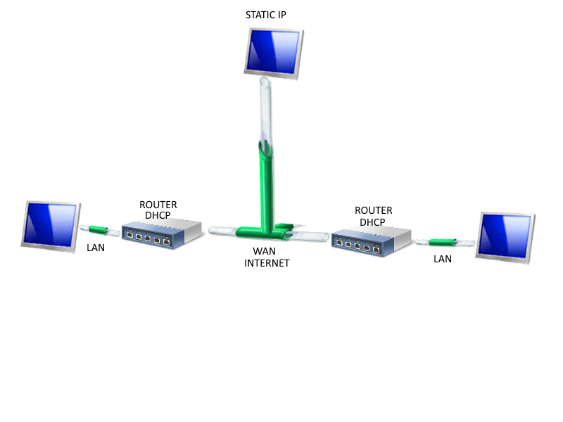

I need more specifics on your setup.. I need to know where the internet is in relation to the machines.
is it something like this.
I guess it really does not matter. so long as a single machine has a static IP address then you can ping pong events.
This is going to be a custom thing to make it work. the network event sender and receiver both use UDP so that will not work. we need to create a direct TCP connection.
the 2 machines with the dynamic IP's are going to have to initiate the connection to the single machine that has the static IP.
Or optionally you can use a service like changeip that provides you with a DDNS host which will periodically sync you IP with their servers to ensure the record is correct.
