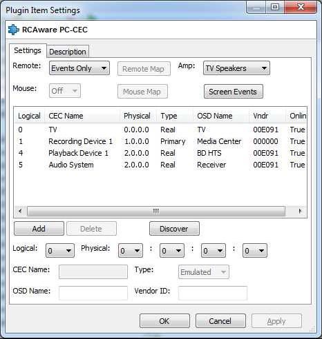

You can do whatever you want but you need additional hardware.brand10 wrote:Is it possible for eventghost to detect the connected Display Device and switch the settings automatically? The Display Device shows the Name of the TV if AV is turned off, and the name of the AV if its turned ON. So all i need is a plugin which triggers an event if a certain Display device is found.
I'm using for a long time now the RCAware HDMI-CEC to USB bridge, with its plugin, and is extremely powerful.
It handles all events in the HDMI chain, allowing EG to interpret and interact with them.
This is an example of how the RCAware plugin reads a common HDMI chain:
Each of the elements of the chain generates events on the bus HDMI, you can use these events to handle any action in EG.
Regards,
xavier.
