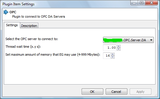

The setting dialog for the OPC server looks typically like this with a drop-down to select the OPC server you like to connect to. The setting for maximum memory usage will be used in all modes (minimized, maximized, windowed)

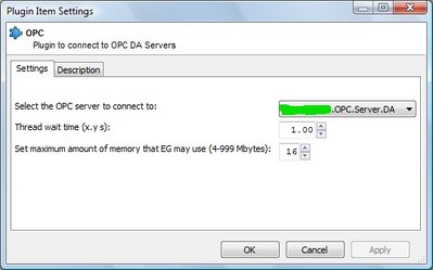

                tag_items = self.items[i]
                for j in range (0,len(tag_items)):
                    value, quality, time = self.opc.read(tag_items[j])
                    tmp = self.previousStatus[i]
                    if value != tmp[j]:
                        eg.TriggerEvent(tag_items[j],payload = value)
                        tmp[j] = value
                self.previousStatus[i] = tmp
            if self.q > 50:
                self.opc.close()
                stopThreadEvent.wait(0.2)
                print "OPC re-connecting"
                self.opc.connect(self.OPC_name)
                self.q = 1
            self.q += 1
        self.opc.close()
        self.bOpcObjectCreated = False
        print self.text.infoThreadStopped
